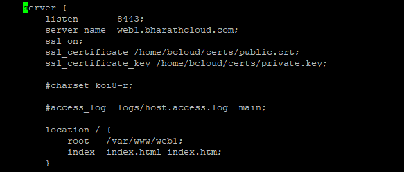

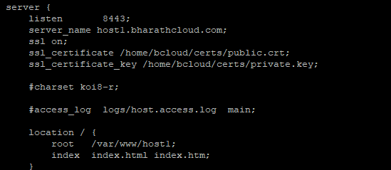

Hi, we have configured multiple hosts(*.conf) in nginx running on same port on two boxes.
Box1: host1.bharathcloud.com web1.bharathcloud.com => 10.2.19.200
Box2: host2.bharathcloud.com web2.bharathcloud.com => 10.2.19.201
Same configuration is done of host2 and web2.
when accessing above url’s individually it’s displaying the required webpage. But when I try to configure it with haproxy to route to backends using host headers.. for URL with web* its displaying webpage of host* and not the one corresponding to web*

server web1 web1.bharathcloud.com:8443 check ssl verify none
server web2 web2.bharathcloud.com:8443 check ssl verify none

server host1 host1.bharathcloud.com:8443 check ssl verify none
server host2 host2.bharathcloud.com:8443 check ssl verify none
Both weblb and hostlb are pointing to same VIP which has been configured using keepalived.
so when I try to access using weblb.bharathcloud.com instead of routing to web backend I am getting web page corresponding to app backend.
It works perfect when I try to configure host1/2 on different port and web1/2 on different port. But when I try to use same port for both its not working.
Request help on this.
