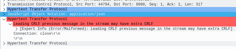

After debugging with wireshark capture I came to know that, haproxy is adding \r\f"Connection: close"\r\f\r\f at the end of the post json data.

This is causing packet parse failure, as it considering POST data as a part of header and reporting extra CRLF in headers.
