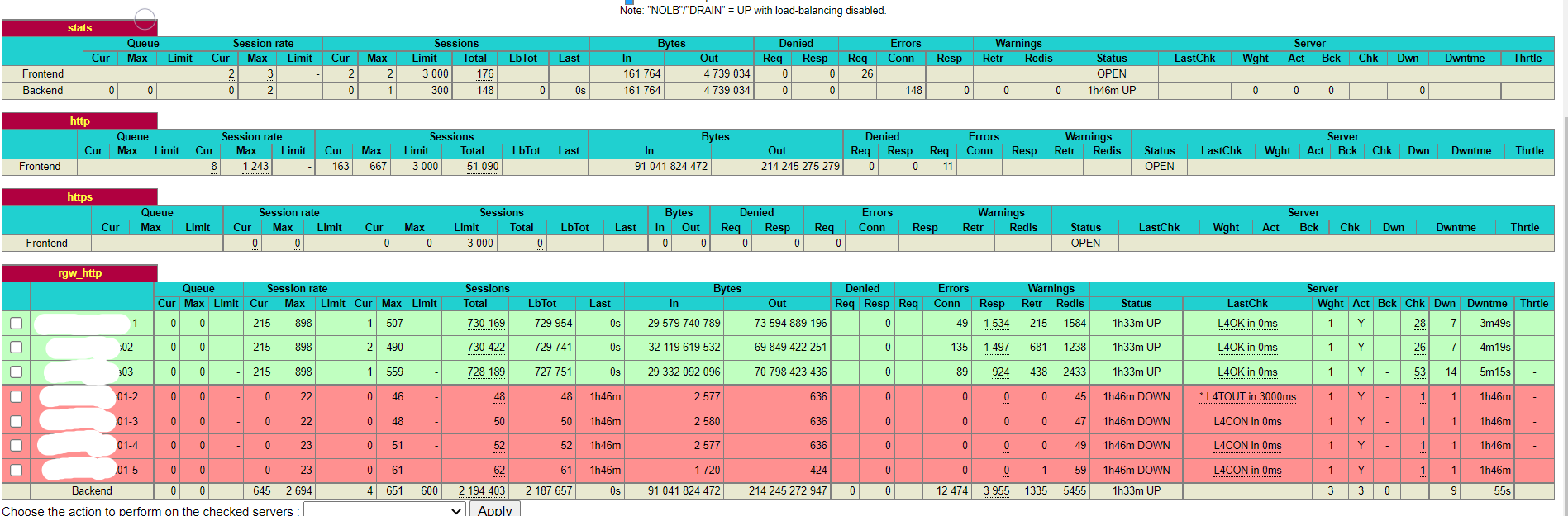

Hello,
I’m using haproxy with my ceph cluster and I’ve created more gateways on 1 server with different ports. I’ve added to the backend configuration with the different port numbers but seems like haproxy ignores it.
What I’m missing from the configuraiton?
This is on the server where the gateways are running:
netstat -an|grep :808
tcp 0 0 10.118.199.1:8084 0.0.0.0:* LISTEN
tcp 0 0 10.118.199.1:8080 0.0.0.0:* LISTEN
tcp 0 0 10.118.199.1:8081 0.0.0.0:* LISTEN
tcp 0 0 10.118.199.1:8082 0.0.0.0:* LISTEN
tcp 0 0 10.118.199.1:8083 0.0.0.0:* LISTEN
tcp 0 0 10.118.199.1:8080 10.100.112.111:56906 TIME_WAIT
This is my haproxy configuration:

backend rgw_http
balance roundrobin
server server01-1 10.118.199.1:8080 check inter 3s
server server02 10.118.199.2:8080 check inter 3s
server server03 10.118.199.3:8080 check inter 3s
server server01-2 10.118.199.1:8081 check inter 3s
server server01-3 10.118.199.1:8082 check inter 3s
server server01-4 10.118.199.1:8083 check inter 3s
server server01-5 10.118.199.1:8084 check inter 3s
This is the stat page:
Thank you.
