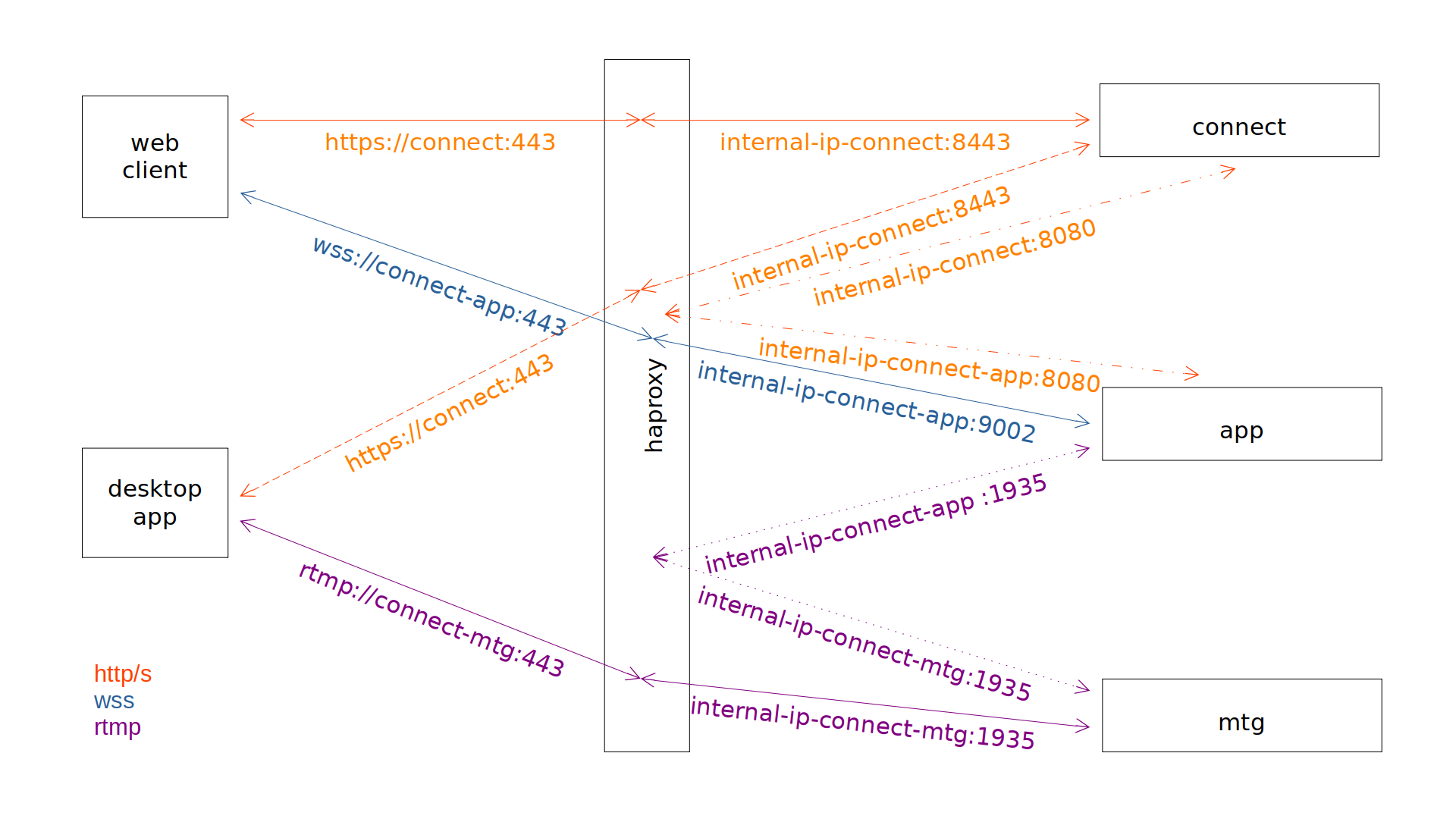

i need help with HAProxy and Adobe Connect. Here is the diagram:
And i followed these links for configuration:
Here is my configuration:

And what i get when i try to connect via websockets:
{"type":"NCFunc","method":"connect","url":"rtmps://connect-mtg:443/?rtmp://localhost:8506/intro/bwcheck","params":{"ticket":"","reconnection":false,"swfUrl":"https://connect-dev/common/ccapps/root-react-app/meetingDiagnosticPage.html"}}
{"method":"onStatus","status":{"code":"NetConnection.Connect.Closed","description":"","encoding":0,"ncDetails":"","type":"status"},"type":"NCSink"}
Any hints?
