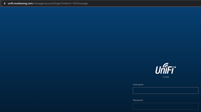

No problem with unifi:

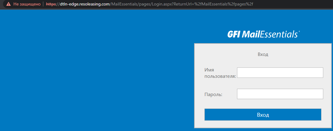

But i have problem with GFI:
For some reason, when I type gfi.resoleasing.com into my browser, I get redirected to dtln-edge and as you can see, the problem is with the certificate.

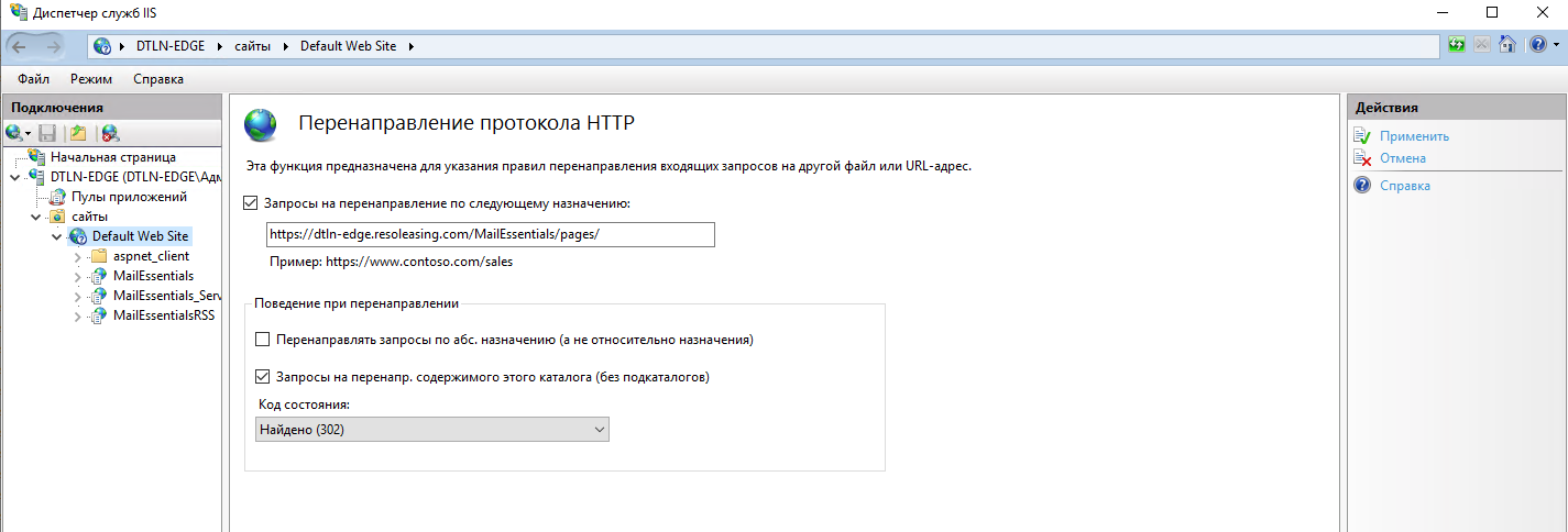

UPD: I found the problem is that it doesn’t work because on the gfi web service I make a redirection rule in IIS:
But it worked with nginx
