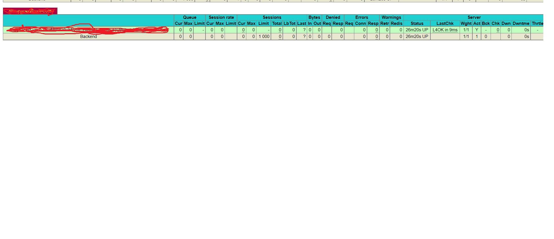

From the status page we are able to see that haproxy is able to connect to backend server..
we load in browser - we get 502 bad gateway error.
Hello,
Your capture is showing that no traffic has been sent to your backend. Maybe it’s just because Haproxy just started. please provide logs to see what append on haproxy.
