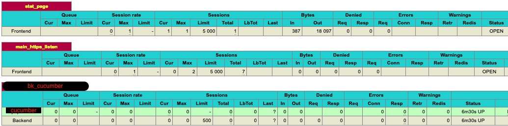

My goal is to be able to reach the servers by the domain even when there is no internet, but I cannot make it work. I have enabled tcp mode for passthrough as per the below config, but no joy. Stats show no matches to backend just the front-end:
