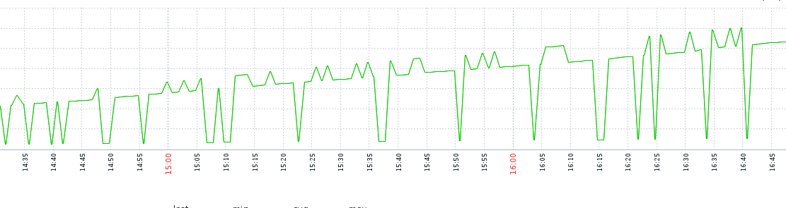

I have some graphs haproxy values ​​and the stot is one of them. This value in the haproxy guide (https://cbonte.github.io/haproxy-dconv/1.6/management.html) is:
  1. stot [LFBS]: cumulative number of connections
When it plots this value shows something like this:
Values in average increase but produces decreases sometimes in this value.
I see the same behavior when I try to collect, each second, this value directly from socket:
echo ‘show info;show stat;show table’ | socat stdio unix-connect:/run/haproxy.sock …

I don’t understand this behavior, may be haproxy configuration? I think that the normal behavior should be only increase with time, isn’t?
if it necessary i can send the configuration or any information that would be required to understand this behavior.
